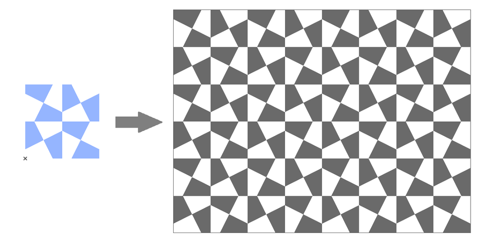

Did you guys know that you can use Fills in the pattern definition of a Symbol Fill? I just accidentally found out about this when by mistake I selected a Fill in addition to a Line, Arc, and Hotspot while drawing the intended Symbol Fill pattern and copy-pasting it in the Fills Dialog. I thought only Lines, Arc/Circles, and Hotspots could be used (not even Polylines).
This capability opens up some new possibilities.
Here is an example:
Two notes:
  • Since a Symbol Fill has one Fill Pattern Pen setting (the whole pattern of the Fill uses the same Pen), all fills in the placed Symbol Fill will be displayed with the same Pen even if the source Fills are using diffrent Pens.

they sure can affect performance. we have a background tree fill that makes elevations suffer the first time you open them. turning off 'true fill appearance' stops it from happening however.
