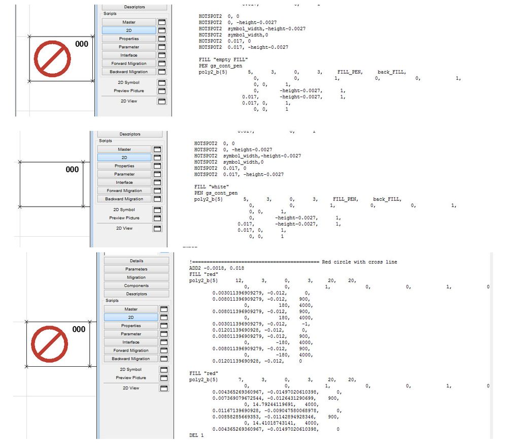

2D Fill overlap? Help?

Hi.
You can either use DRAWINDEX or change the order in which things are scripted (i.e. bottom fill first)
Best regards.

Or is it just a case that your 'back_FILL' parameter is not set to the transparent (0) pen?

Barry wrote:I have solved it now. DRAWINDEX worked nicely, thanks.
