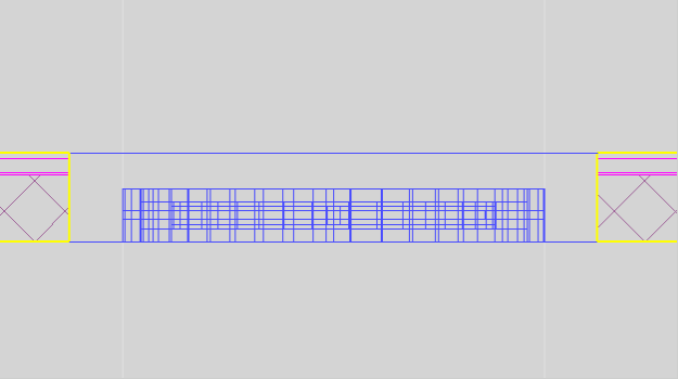

I created a custom gothic window with terracotta trim on the exterior side. I'm familiar with copying and pasting parameters for the WALLHOLE function and cleaning up my 2D symbol.
What is new to me is since I included terracotta trim, the window opening on my floorplan follows the overall size including terracotta trim. This is also after I input the WALLHOLE code. I tried deleting the 2D work of the trim and selected everything in that area but the gap still remains. Is there a way to enclose the gap for my 2D representation to follow the WALLHOLE settings? Is the only solution putting in fills in my GDL 2D symbol to line up with wall composites?

Alternatively save the pieces as a library part,
File>Libraries & Objects> save 3D Model as
and choose window as the type of library part.
When you create the custom window elements in the floor plan, 0,0 on the global origin, is the reference line. What is above will go in the wall. What is below will stick out of the wall.
You can always fudge by adjusting how the window sits in the wall.
Dealing with WALLHOLE is the fairly old (prior to 5 or so years ago) way of doing this. What you want is to include a slab for which you set the ID field to be "wallhole". Be sure only one slab in your assembly has that ID (and if so, that none have the alternative id of "wallniche").
Make that wallhole slab correspond exactly to the hole that you want cut - in other words, it should reside completely inside all of your terracotta trim (or perhaps extend the thickness of the trim that wraps the opening).

Yes - it makes the assembly a niche rather than a window/door. The wallhole always cuts through the entire width of the wall, even if the wallhole slab is 1 cm thick and the wall is 50 cm thick. The wallniche removes part of the wall to allow creating objects similar to the niche elements in the library.
Unless the window/door must be parametric, the visual-build method is very efficient, other than cleaning up the 2D symbol - but that is done graphically in the 2D window of the GDL editor.

Getting back to the original problem, I suspect it's a problem with the A value being automatically set to 1m. (or 3'-3 3/8") AC's default value. By setting the A value of the window to the correct width the symbol should display properly.

The 'wallhole' shape will define the 3D hole, but not the 2D hole as you have seen - if you are looking at a symbolic view of the door or window.
To get the symbolic 2D to show properly with your own trim, you have a several choices. I'm not sure which is best in practice as I haven't done this often enough other than for one-offs.
See attached. The A width is used to determine the opening width in 2D. The default A value is the overall width of your custom elements - the outside of the trim pieces.
So, you can either (a) reduce the value of A in the parameter list to subtract your trim width, or (b) click the Details button and change the oversize values. (Option b is required if the trim is not symmetrical.)
Click on the 2D Symbol button to view your changes while you remain in the GDL editor until things look right.
Note that neither of these will work if you stretch your door/window to be wider/narrower than how it was modeled, as the trim will change size too.
