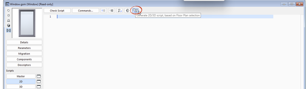

It's been a while since I've created custom library objects, but I was previously able to drag and drop anything from the Archicad plan window to the 2D or 3D script window of the library object and the GDL script would automatically be generated. What happened?
ArchiCAD 29, Windows 11
1 Solution
It has changed to a button in the script window.
Can now also be used in the 3D script.
Go to post
2 Replies 2
