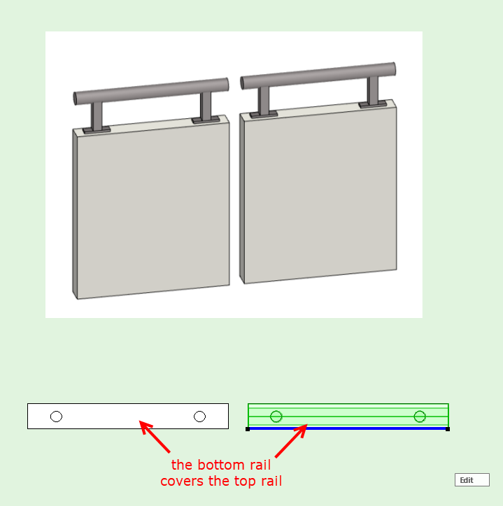

There are no controls that I am aware of.
I have a rail where the bottom rail (the brick modelled as a rail) hides the top rail, which clearly should be seen as it is on top.
It is there as you can see when I select it.
Just the display order is wrong.
This was brought to Graphisoft's attention way back when railing were first included.
When I get the motivation, I will report it again.
