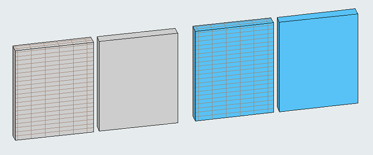

With surfaces you will only see the foreground (hatch pattern) of the fill and not the background.
This way in the basic 3D engine you see the surface colour you have set for that particular surface and in Hardware Acceleration engine (OpenGL), you will see the texture image if you have one.
The surface colour or texture is your background.
For the hatch you will only see the foreground lines and you can choose to use the element's uncut pen colour or you can set a specific colour.
So in your case you would have to set up 2 surface materials, one with a cover fill and one without.
Repeat for each different colour/texture that you need.

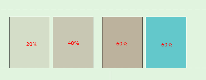

All I can suggest as a workaround is to set up the glass splashback surface with a percentage fill rather than the 'stonework stressed' fill (diagonal lines).
You can create multiple splashback surfaces, 20%, 40%, 60%, etc.
You can set different colour hatch pens as well.
But they won't have much of an impact if you are going for the greyscale look and you end up printing in greyscale.
You will then have different shades of grey (or what ever pen colour you choose) for the different surfaces, but you won't have the diagonal lines unless you add a separate fill again.
