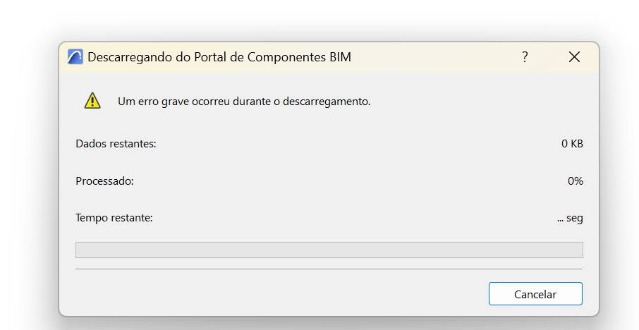

Archicad 26 does not allow me to see when searching objects the BIM Components options to download (yes it's selected to appear). Even on the website I can't "drag to Archicad" because also gets a serious error.
I'm using the Archicad 26 5006 BRA EDU up to date till now 05/16/2023

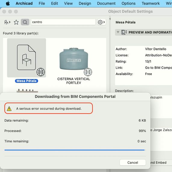

I searched for 'centro' as you did, and attempted to download/embed one of the objects found and got a similar error to yours after 99% downloaded:
Same error if dragging Mesa Pétala from the BIM Components web site.  So, there is an error with that object.
I then did a search for a different keyword ("lounge") and successfully downloaded/embedded and placed a chair.
See if you are able to download/embed/place other objects, and also report the issue you are having with full details both to [email protected]  (with the URL of the problematic object[s]) as well as to any technical support contact that is available for EDU users.
