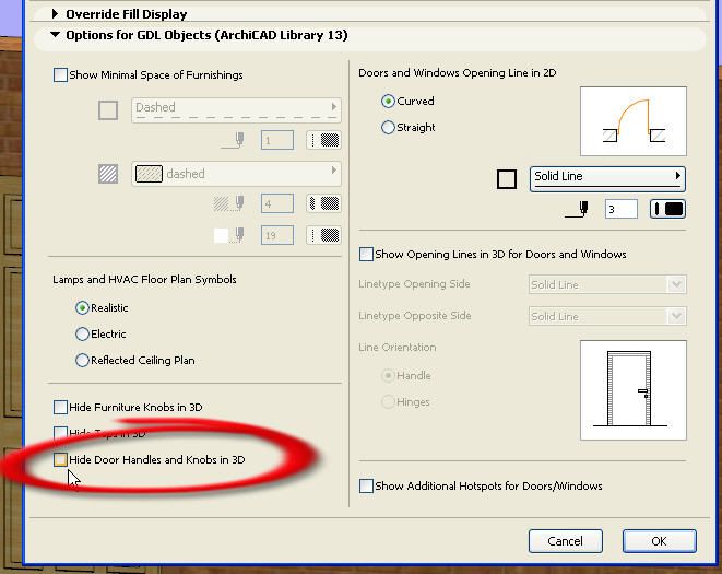

There is now a parameter in the Model View Options that controls the visibility of door handles and other options as well.
In V13 it is a global on/off setting and you can't control it on an object by object basis.
In V14 I believe there is now an option you can choose in the objects to use the MVO settings or not.
Do a search in the forum for "Model view Options" if you want to see other post on the subject.

I just had a look at a couple of the AC doors in 13.
There is a setting where you can choose the handle - by default it seems to be set as "None".
You can also control the visibility with the MVO settings.
See image in next post.
MVO setting.
Thank you Berry.
That was the answer. The handles are set as "None".
I had never set this one!.
