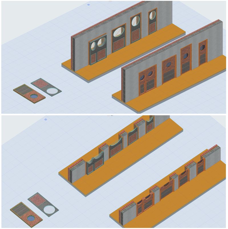

I am doing some tests to create a custom door panel.
If I create it by modeling it with the basic tools of archicad, such as slab, the door panel does not have the editable materials and is stretched based on the size of the door.
By creating the door panel through PARAM-O, the panel maintains the proportions even as the door size changes, but I cannot change the parameters used in PARAM-O to create the object.
Is there any way to add a panel to the door interface text panel that goes to read the parameters of the custom panel?
I attach an example file and two door panel gsm file, one modeled by slab, other by PARAM-O.

Out of the box this is not possible.
You will have to do a bit of GDL scripting - even then it is not practical.
You would have to edit the default door frame objects to pass on the parameters you want to control as the object CALLs the custom door leaf.
Editing the default Graphisoft objects is not a good idea.
Also you would have to ensure the custom door leaf you create also has the parameters that you wish to change.
Creating them from slabs, it will create parameters for the materials, but they will not necessarily match with the same parameter names from the frame object, so some adjustments would be necessary.
I am not sure exactly how Paramo creates custom door leafs as I really have never used it as it is not as powerful as scripting in GDL.
