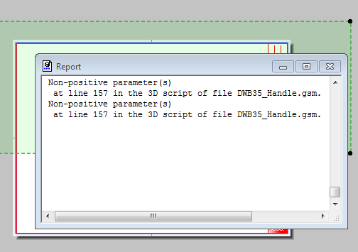

I keep getting these reports when generating a 3D image or elevations
I have tried un ticking the "write report" box, but then I get an error message instead so I went to full report & got this, I dont know what it means & would like them to stop.

There is a problem in the scripts of some library parts. Since the file noted is "DWB35_Handle.gsm" I would guess the issue is with a door handle (is DWB Door Window Builder?). Use the Marquee Tool to see parts of the model in the 3D Window until you can find where these parts are, then open their settings dialog boxes, change the preview to a 3D option (the error message should appear in the dialog box), then try changing parameters until the error message disappears.

I have done as you suggest & appears to be handles on a Cadimage door!

That error is coming from (Doors + Windows), yes.
It's hard to say why it's happening though - we'd need to have a look at a MOD or PLN of it to be able to figure out how to fix it.
Could you just send an email to us at support@cadimagegroup.com, and we will follow it up from there.
