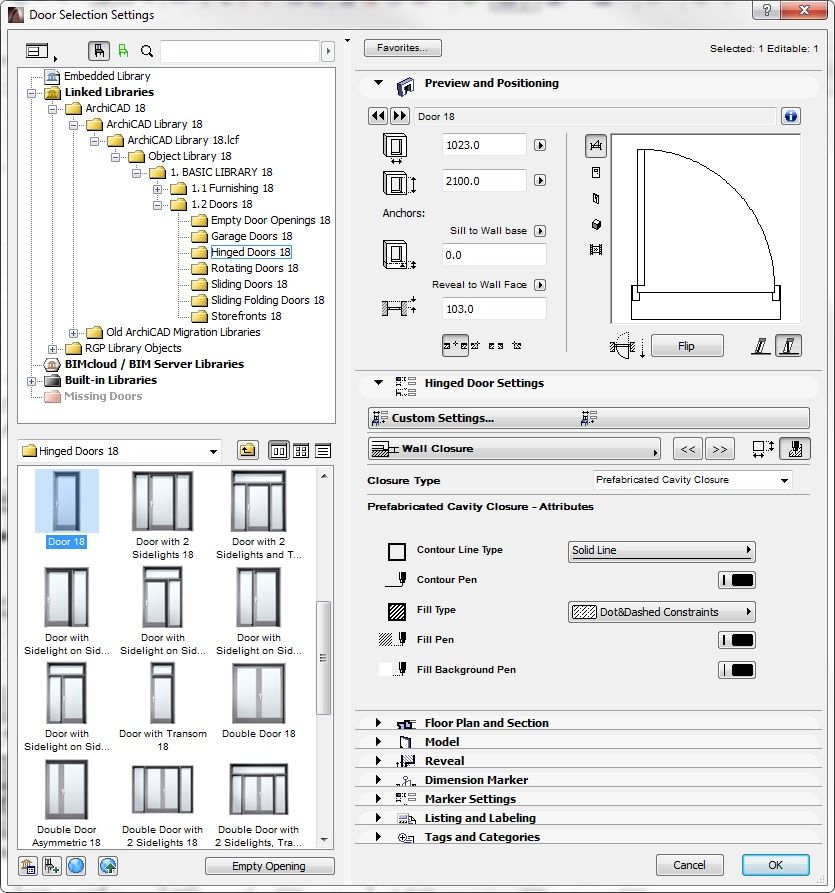

I can't seem to find the option to change the wall closure attributes in ArchiCAD 19. In 18 you could change the line type and fill type of the closure (as shown on the screenshot), but I can't find these settings in 19. Please help!

Hello!
They should be there.
See Attached Image.
arqrivas wrote:
Hello!
See Attached Image.
Yes this lets you change the type of closure but doesn't let you change it's attributes in terms of fill or line! I need to change the fill within the closure...not the type of closure.
In the door settings, the drop down menu should have a category near the bottom called "floor plan and section". Attributes for wall closure can be adjusted within, however only once a type of wall closure has been selected; if the wall closure is set to "no closure" attribute options don't appear as part of floor plan options.
