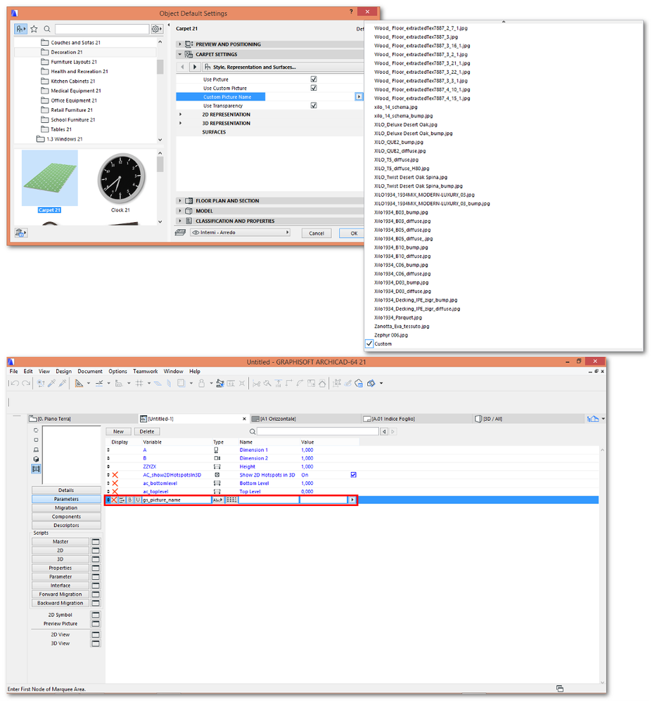

Hello to all,
what is the script to automatically see the images in the library inside an object (for example object Carpet)?
At the moment it only works if I enter the parameter gs_picture_name.
Is it possible to use this function also with other parameters?
Thanks so much
3 Replies 3
You have to paste the image into "preview picture"
Piotr
Jochen Suehlo
Moderator Emeritus
You can find the Script for this in the automatically loaded "ArchiCAD_Library_Master.gsm". In the MasterScript there is:
dim	stCustomPicFiles[]
bCustomPicFileExist	= APPLICATION_QUERY ("LIBRARY_MANAGER", "USER_IMAGE_FILES", stCustomPicFiles)
if bCustomPicFileExist then
	values "gs_picture_name" stCustomPicFiles, CUSTOM
	values "gs_picture_name_2D" stCustomPicFiles, CUSTOM
endif
So at least you can use gs_picture_name_2D.
Or you can define your own using the Application Query above (I hope)
