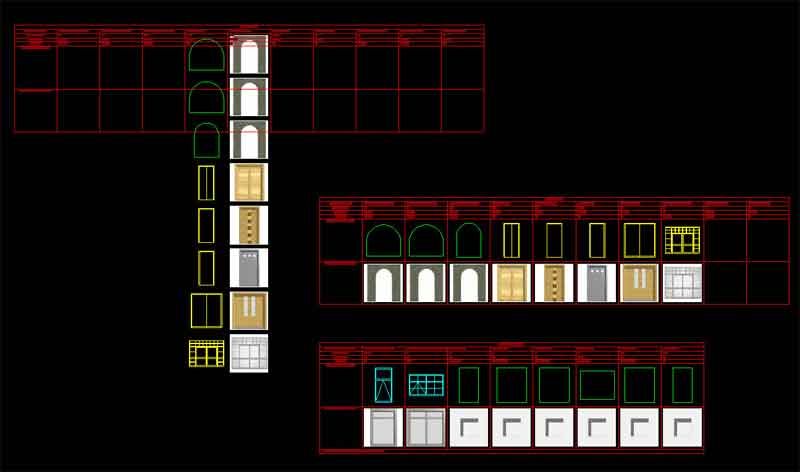

if i have a vertical and an horizontal door schedules showing 'preview pictures' and i want to make them all horizontal or vertical, i could get the attributes from one and pass it to the other, schedule format will take the attributes but the 'preview picture' will remain same position (off the schedule) ?? attached pictures..(learning how to attach pics)

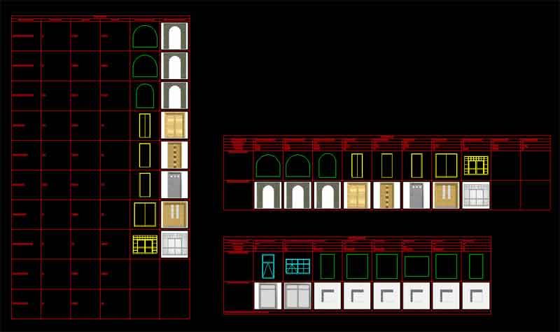

and after

It is not so much a bug IMHO, but simply the way in which placed schedules operate. While the schedule itself is a GDL object, it is not intended that we should be able to alt-click on one and ctrl-alt-click the settings to another. The GDL object does not contain the schedule settings - particularly the placement of the images, as you've seen. The schedule block is grouped with the images, and you must select all of it (grouped) and reformat using the I.S. itself.
Just open I.S., edit settings, and change from column to row.
Unfortunatley, if you want the fonts/spacing/etc to match, that isn't an option. You'll have to set the other schedule to match. Parameter transfer will APPEAR to transfer font sizes, but when you open the schedule settings, you'll see that the settings themselves retain their original values.
If parameter transfer 'worked', then the schedules would be identical, and that wouldn't help at all! I suppose a good wish would be for just formatting to be transferred.
You know also, of course, that you must not suspend groups when doing an update. Grouping must be enabled so that when you select any part of the schedule, all parts - the text block (GDL object) and the linework/images are all selected, and so then all will be updated. Without doing this, duplicate linework/images will result.
Hope that helps,
Karl
