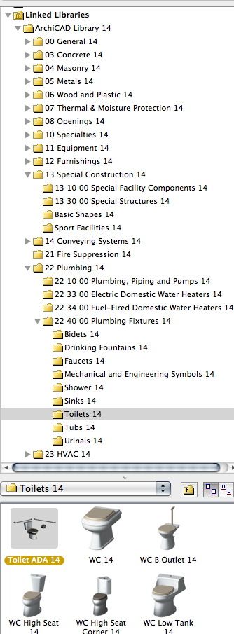

Je ne sais pas si je serais comprise par quelqu'un mais j'ai un probleme avec ma bibliothèque... Je n'ai aucun objet "sanitaires" ... Je ne comprends pas.. J'ai même désintallé-réinstallé archicad mais rien n'y fait ...

Be sure that the Library Manager has loaded "Object Library 14.lcf"
The attached image shows the location of the sanitary fixtures within the library.

Also, if you have the MEP add-on installed, these fixtures will not show up with the Object Tool ... instead they will show up with the MEP tools...

It looks like this has been fixed. For example, in AC 14, with MEP License, I can use the WC fixtures in Dwight's screen shot using either the Object Tool or the Equipment Tool (MEP). But once the part is placed, selecting it will show it as a piece of Equipment, regardless of being originally placed with the Object Tool or Equipment Tool.
