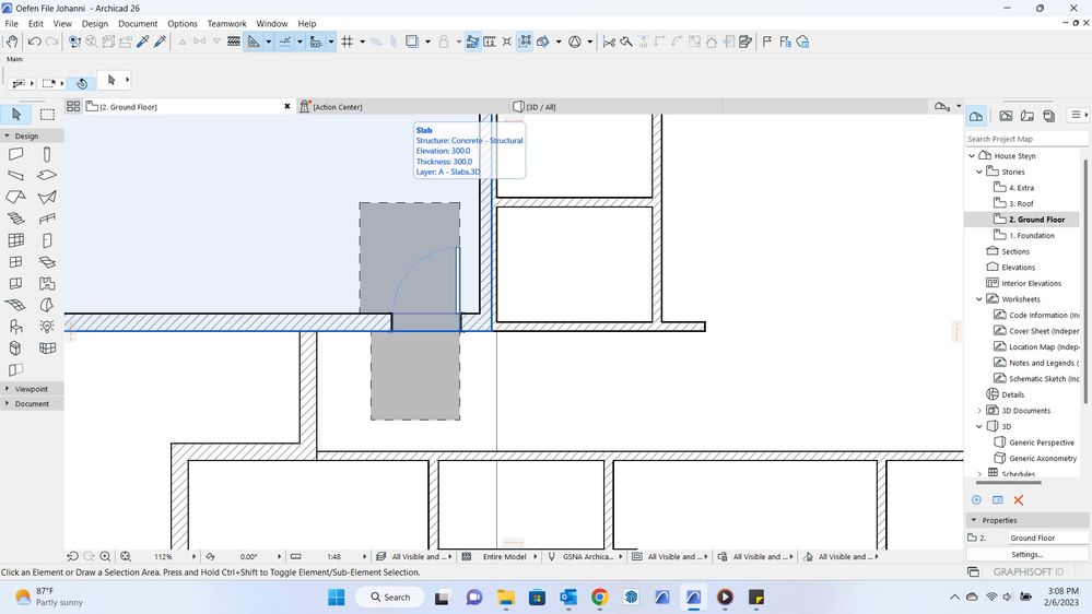

Block around door in floor plan that I can't get to go away.
I can't get the block to go away. Please see in picture.

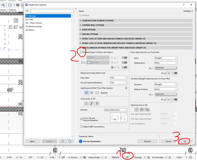

mija
You have to turn off minimal space in Model View Options

Johanni
Thank you!! Problem Solved.
