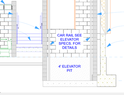

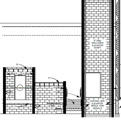

Hi, I’m having an issue creating CMU blocks with the correct hatch pattern. The hatch appears to be too dense, making the CMU block look almost completely black. I don’t see an option to adjust the fill or hatch density to make it lighter.
How do you change the density of the CMU object, so it appears less dense?
Thank you!
Solved! Go to Solution.
2026-10-01 01:14 AM
Go to the Options > Element Attributes > Fills Dialog, and redefine the size of the Fill.
If the Fill is a Vector Fill, you can set the X and Y Pattern Unit Size to, e.g., double its current size.
If the Fill is a Symbol Fill, you can set the X and Y Scale.
