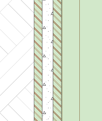

A wall composite with diagonal fills is shown as a solid fill in plan with a graphic override and with the diagonal fill in section.
In the case of a concrete filled cavity wall, how can I have the concrete show solid in plan as white but with a concrete fill pattern in section? The below example section is drawn using a 2d fill for the concrete.

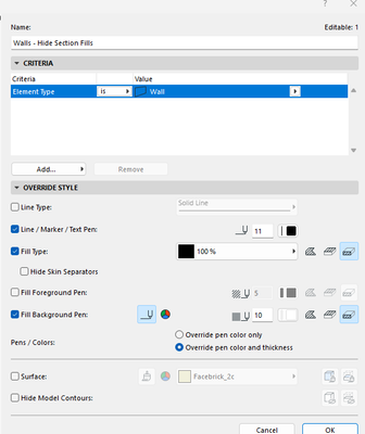

This is the GO rule that hides the fills in plan.

There is a limitation in Archicad, which is that Graphic Overrides always work on the whole element. There is no way currently to override only specific skins of a Composite, for example. There is already a wish for this functionality, if you want to vote for it:

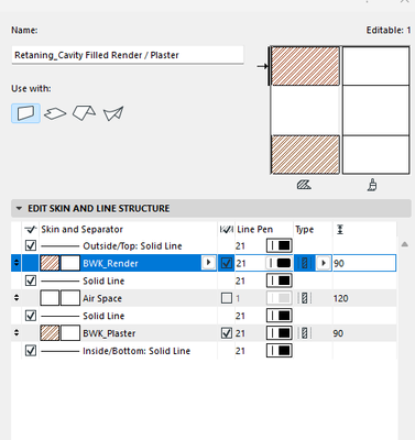

you would need to model sections of the wall using separate walls so that only the intended walls are affected by the graphic overrides.
general Archicad rule: model with as few elements as is reasonable to get the level of detail/precision that is required. In this case, fewer elements may just not be reasonable.
we run into the same thing with renovation/remodels where walls are stripped down to the studs. Model as-built with just framing, then the new skins are shown as additional walls. we don't usually show plaster/gyp as demo, so its fine.

You could make your concrete fill "solid" by changing Pen Set to one where your concrete foreground pen is the same as your background pen.
