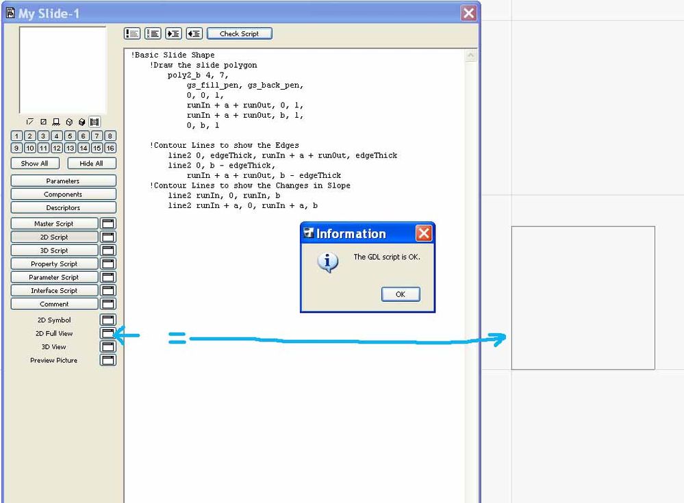

I've read ahead up to page 50 and think I understand the easier stuff.
But thought I'd jump back to page 21 and actually enter some code you suggest on 21.
I made a new object>selected a subtype (My playground) I had made from previous instructions.
I copy pasted the code from page 21 object I downloaded (to make sure I did not make a typing error) and as you can see, the script says it's ok, but does not give me the 2d image as you show when I hit the
2d full view. I get the box on the right.
Any guesses on what I may have screwed up Andrew?
thanks
Lec, I think the trouble with the slide object is the default parameter values.
If you change the values to:
a = 10'-0"
b = 2'-0"
zzyzx = 6'-0"
runIn = 3'-0"
runOut = 3'-0"
the result should more closely resemble the illustration.
Andrew
Well thanks for the reply!
I changed the A, B, and zzyzx in parameters
as that seemed obviously what you meant.
Looked at script and could not see where to change runIn/runOut.
So, I then created the parameters runIn and runOut
and defined them as 3' each.
I then got, as you said, something closer to what is in book.
Is this what you meant me to do?
If it is, I'm feeling pretty good.
If not, I'll go at it again tomorrow.
Getting late here again.
Yes that's right, Lec.
Thanks Andrew!
I'm overjoyed!
Well at least glad.
Now have made a quantum leap to 3d script on page 22.
Again pasted from downloaded .gsm and got extra script call out for parameter Material slideMat which of course is not in the book so my bad.
Ran it and came up with error, of course!
So I made material for slideMat and that error went away.
However, also was, and still am,(even if I delete my added material and call out for it in script) getting error about "polygon degenerated" in line (my 4 since I added material), but even if I delete my added slideMat
(so script is as it is in book) I sill get this polygon "degenerated error"
regarding; tube 8, 6, 51,
And of course, it won't generate 3d image.
Hints again?
Hi Lec,
It sounds like you are gaining in confidence! Yes you'll see a lot of error messages. The trick as you've found is to interpret them and understand why they occur.
However, also was, and still am ... getting error about "polygon degenerated" in line ... 4 ... And of course, it won't generate 3d image.
Hints again?
If you look at the 'tube' command, you'll see two variables edgeHeight and edgeThick. You'll need to add corresponding parameters to the Parameters list, and set some default values (say 8" and 3").
Well, thanks again.
Worked perfectly.
I now see I should have gotten this one on my own , based on other examples you provided.
I guess I let the warning dialog stop my thinking on line 4.
This was a simple one.
I'll try not to make that mistake again!
