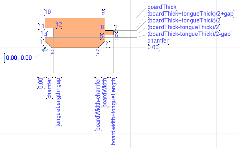

Hi Andrew,
I really like page 65, somehow is easy to relate to for me, being a board and nail kinda guy. So I hope I’m not asking too much, but could you annotate some of this page for me to study.
Others in my beginning stage might like it also I would assume.
I feel if I get this page totally, I would have a foothold to stand on.
I have put a bit of time into modifying and adjusting script to see what happens, but still can’t figure it all out.
Also would it be hard for you to make simple 3d script for these boards to study?
!Fill and Pen
pen boardPen I get this
fill boardFill I get this
!Hotspots
hotspot2 0, 0 Why not call 1st one hotspot1?
hotspot2 a, 0 How does the “a” HS seem to know to go to near end of last board?
!Place a row of boards
for x = 0 to a step boardWidth + gap The beginning board location call out, right?
add2 x, 0 Add two times board to get next board start?
gosub "Tongue & Groove Board" I get this.
del 1 Why does this not delete the gosub just above?
next x I get this, (Ithink) (a loop?)
end I get this.
"Tongue & Groove Board": I get this
poly2 14, 7, Messed with different numbers but did not “get it.”
0, chamfer, How does script know to put chamfer on bottom?
chamfer, 0, Can you also annotate the remaining lines?
boardWidth - chamfer, 0,
boardWidth, chamfer,
boardWidth, (boardThick - tongueThick)/2,
boardWidth + tongueLength, (boardThick - tongueThick)/2,
boardWidth + tongueLength, (boardThick + tongueThick)/2,
boardWidth, (boardThick + tongueThick)/2,
boardWidth, boardThick,
0, boardThick,
0, (boardThick + tongueThick)/2 + gap,
tongueLength, (boardThick + tongueThick)/2 + gap,
tongueLength, (boardThick - tongueThick)/2 - gap,
0, (boardThick - tongueThick)/2 - gap
Return why does this not say end?
Thanks again for all your help.
PS; Also played with “gap” parameter that was set as 0’ and yet there was a gap.
I changed it to 1/8” and gap got larger as I suspected, Then tried to change to 1/16” but it kept reverting
back to original 0’ but now at 0’ there was no actual gap. Did not understand that.
And why can’t I get 1/16th to work. Is it a mm to inch issue?
(Tried to attach a word.doc that I had formatted to read easier but would not accept .doc I found out) That's why there are no spaces between your script and my questions.

I don't have the book, so I am a guest, here. But I can try to give some answer...
hmmm in GDL there are two commands for the HotSpots. One is "HOTSPOT" and is for the 3D script, and the other is "HOTSPOT2" and is for the 2D symbol. The number "2" here is part of the command name, so you can't change it!
The two numbers after the "HOTSPOT2" are the coordinates (X and Y), so the place where the hotspot goes. "a" is the parameter that hold the width of your object (is the very first, if you look at the "parameters" list of the object).
The "DEL" command only cancel the effect of the last performed transformation of the "stack". These are: MUL2 MUL MULX MULY MULZ ADD2 ADD ADDx ADDy ADDz
You can't mess them. "14" is the number of nodes, and must correspond to the coordinates pairs that follow. "7" is a code that says to make a polygon BORDERED (1), FILLED (2), CLOSED (4). 1+2+4=7
The script execution do NOT ends here. We are in a subroutine, and we have to go back to the calling point (just after the GOSUB)
In the POLY2 command, each line, after the first one, is a coordinate pair: X and Y of a node.
YOU decide the shape of the poly, and write down all the coordinates in order. Starting at one point and following the perimeter (preferably in counter-clock direction).
The board, as you see in the image below, has 14 nodes (and 14 is the first parameter needed by the POLY2 command). As you have learnt, the coordinate can be numbers, variables and formulas.

Now I realize how the script knows how to put the chamfer on the bottom,(along the x as 0 cord.) If I wanted it on top I'd have to move up the y axis and move along the x cord), anyway what I just wrote may not be clear, but I get that part ok now.
