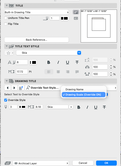

Could you show some images of 27 and 29?
This is what I see in 29 and it is exactly the same for me as 27.
joelsdg
Barry,

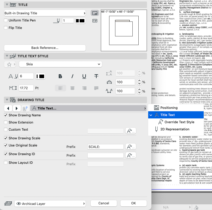

Here is what I see in AC 29 when I select the various check boxes for options of what the Title Block shows, and the resulting Override selections that appear (or do not appear).
In AC 27, I get what you said you get in 29.

You need to tick the 'Layout ID' box to see it in the overrides.

joelsdg
Hi Barry,
Thank you for trying to help me.  My problem seems to be that I want the Drawing ID to show in the Title, not the Layout ID.  And when I check the box for Drawing ID, and click the override settings, Drawing ID is not available in the pulldown, only Drawing Name and Drawing Scale are listed. That is what I was attempting to demonstrate with my screenshots.
Does that help clarify my problem?

I think that might be a bug.
Clicking the button to take you to the override settings, it will simply show 'Drawing Name' or 'Drawing Scale'.
Clicking that button from Name or Scale or Layout ID does open with the correct option.
There is no 'Drawing ID' and none of the other overrides affect the Drawing ID. 
But the same is happening for me even in version 25.
So I suspect it has always been that way with the built-in title.
