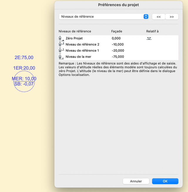

Hello all,
It seems that the built-in property Builtin.General_BottomElevationToSeaLevel actually points to the Builtin.General_BottomElevationToSecondReferenceLevel and vice-versa... tested in AC27 and 28.
Can you please fix it?
Thanks !
