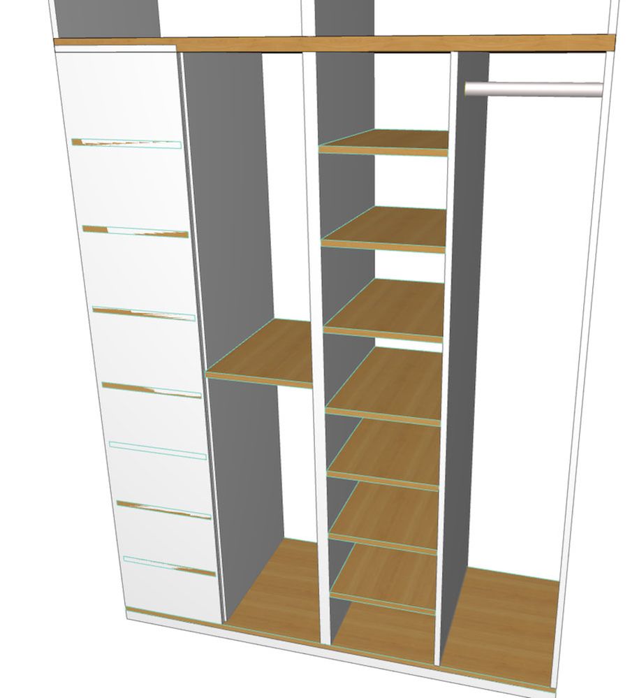

What's the best way to temporarily hide a object, then "un-hide" it again?
For example, I've drawn a door (left), but now need to hide it so I can trim the shelves by 20mm in my 3D view.
Temporarily place it in another layer that is turned off then bring it back to the original layer.
Or if it is in its own layer then just turn that off.
Or place a marquee halfway through the width of the door so you can easily see the shelves and select them.
Or you could try locking the elements you don't want to move (door & side panels) and then stretching the shelves in plan with the marquee.
There are probably some other methods as well.
A good tip if you select all the shelves then group them so if you need them in future you can select just one to select them all at the same time so long as "Enable groups" is active.
If you want to select the shelves separately then make sure the "Disable groups" is active.

Barry, I've attempted the grouped option, but no longer get a "stretch or Offset" command in the pet pallet.
Grouping just allows you to select all the shelves easily at one time.
To edit you will need to "Suspend Groups" groups and you will be able to stretch the edges.
So enable when selecting but suspend when editing.
A marquee in the floor plan would allow you to stretch all the shelf edges in one go (but you must suspend the groups still).

As for the shelves behind the door, you can simply select all (ctrl-a) then shift click on the the door (deselect) and F5 (show selection in 3D). Someone is not aware that this can also be done when we are already in a 3D view.
