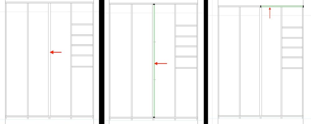

Trying to overcome this problem.
I'm drawing some custom made robes using slabs/walls, but due to the material being the same, the middle line ends up blending in.
I need where the arrow is show a line representing tow 20mm vertical panels.
Forgot attachement...
Duplicate your material - creating essentially the same material but with a new name.
So long as the materials on each joining slab/wall have different names then you will see a line between them.
This is better than setting tiny gaps between them which is another method.
Brilliant Barry, thanks for that tip 😉
