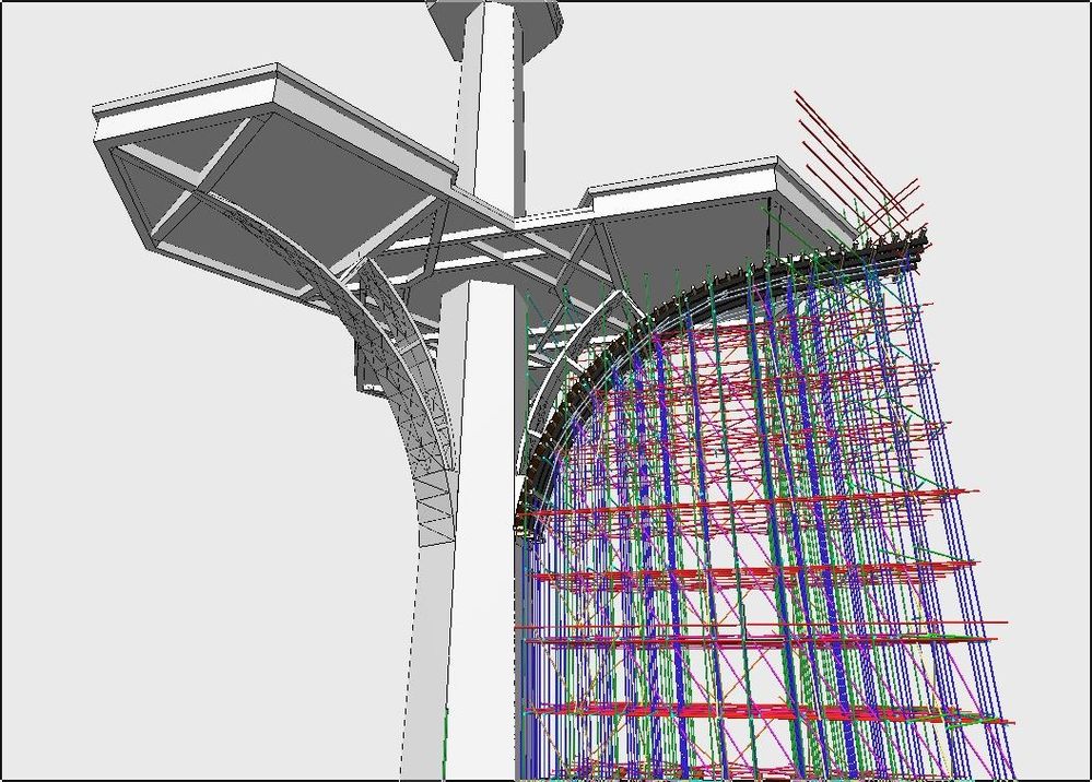

This projects that i work now in tv tower in monte negro and it cant be done without addons !
When i finish this one, i will post it somewhere here just to show what else can be done in archicad powered by some addons !
