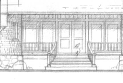

I am looking for an ArchiCAD library part/object that I can use to model a curved stair railing as shown in the attached image. Does anyone know of an object that can model a curved stair railing like this one?

It's worth checking out ArchiStair by Cigraph. It's a fantastic tool allowing you to create, well basically any type of stair.

The new Profiler from Cadimage definitely should be able to handle that.

Stair and railing: ArchiStair.

Thanks for pointing me back to ArchiStair. I had looked at it before and decided that it didn't do what I wanted. Now that I look at the curved stair it looks like just what I need.
