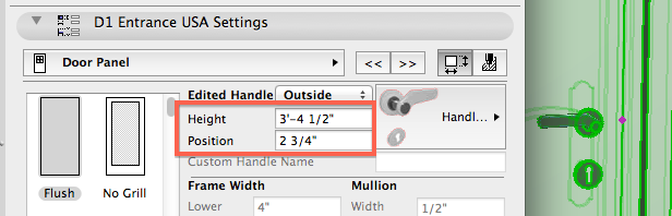

Carl, if you do it that way, how do you get the handle to show up where you want? That is, I want a backset of 2 3/4" and a height of 3'4 1/2". How can I do that accurately?

The position of the handle (center/bore?) is determined by the object parameters - attached screenshot.
