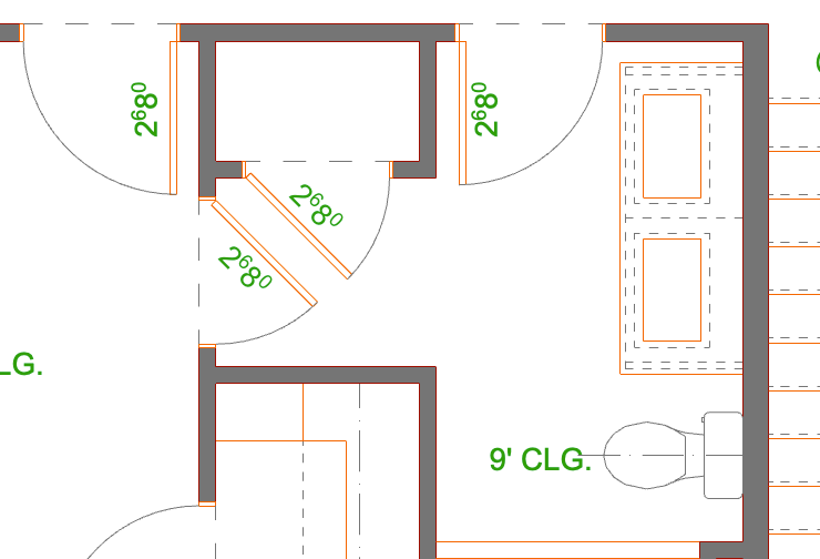

Is there a way to create an automatic custom Door Marker where the width feet is standard text width inches superscript text height feet standard text height inches superscript text (2680) similar to the attached pic? Ideally the text would follow the door slab angle or be able to manually place and rotate the text.
