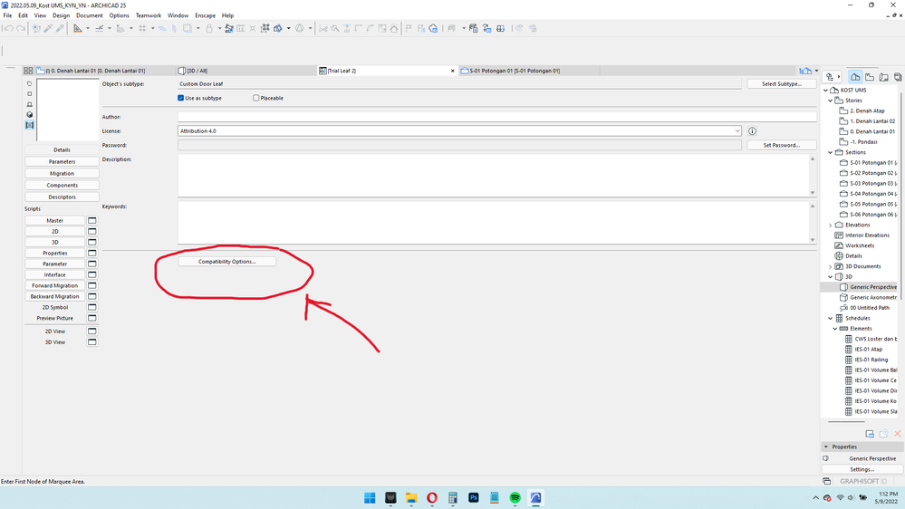

ndesain studio
Hi Everyone,
in my case a just need to change Compatibility Option in my Custom Door Leaf
