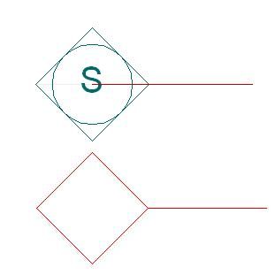

I have used an AC 10 section marker and altered its script to get close to what I need. I am still a little off. I have included a screen shot of where I am (the top marker) and where I need to be (the bottom marker). The bottom marker doesn't show the text but it needs to remain as seen in the top marker.

It would probably be easier if you posted the code.
To get rid of the circle just look for the Circle2 statement (or some form of Poly2 perhaps) and delete it.
To clean up the leader you need to change its starting point or cover it with a Poly2 (this will also require using the DRAWINDEX to get the polygon to cover the line).
The text bit should be obvious.
The Marker I started with was the Elevation Marker 10 that ships standard in AC 10. I looked for the circle2 and deleted it. It looked like this !!!circle2 0,(y/2+(t-n/8)*y/n)*x,0.01
20:
style "sheet5
It removed my text also. I looked for poly2 text line and there are a lot of them! I have attached the code and I am still playing
