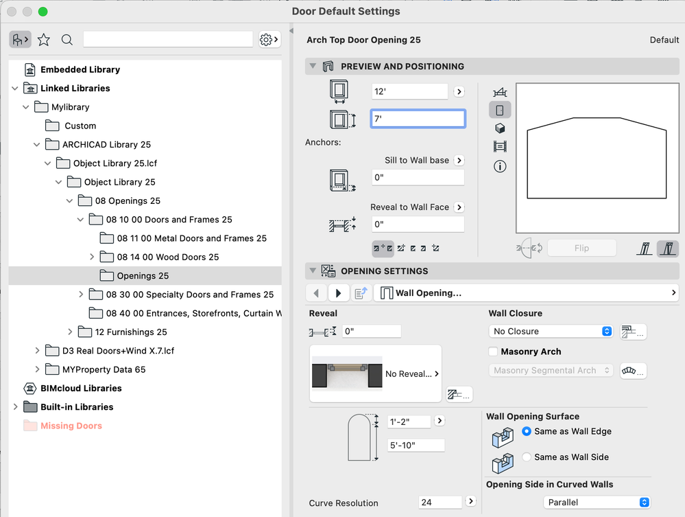

Still?????  I get 3 segments on a 12' opening???? So much for fixing this by 2022 Ac25.  My kitchen cabinet still look ridiculous with an arched opening in the back.  I hope they are not building it like that... 🙄

Have you tried increasing the curve resolution value that you can see at the bottom of your screen shot?
Well, that embarrassing!!  I looked in evey panel for that, but not in plan sight.  Thanks Berry
