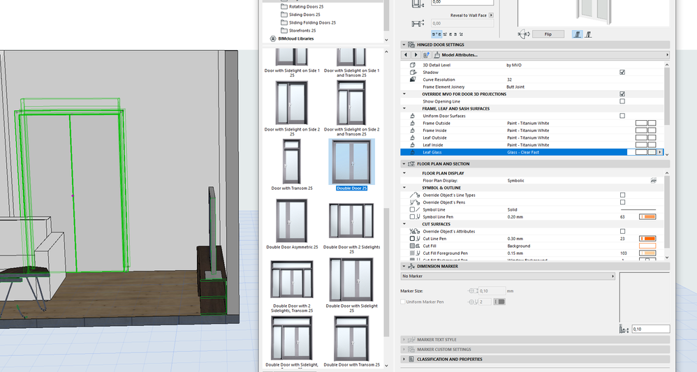

Do you maybe know why all of a sudden my doors stopped showing glass leaves in 3D although it is selected as material? I have had the same problem in the past before, again came out from nothing but I do not remember how I solved it. At the same project the double beds lost their 2d detail level that was set to symbolic and went to MBO if that helps anyone - maybe I clicked on some keys and it was a shortcut I do not know?
1 ACCEPTED SOLUTION
Solution

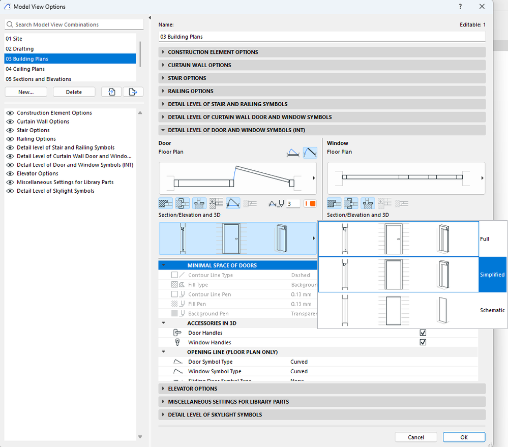

If you look at the parameters in your screenshot, it says "3D Detail Level" "By MVO". This means that the Model View Option Settings controls how the Door is displayed. Please check if the current setting in the MVO Dialog is such that it will not display the Door in great enough detail to show the glasses. Maybe they are set to "Simplified".
3 REPLIES 3
Solution
You are God sent! Thank you so much! That was it! How many settings..... although I have not changed that recently maybe it is a shortcut or a general setting somewhere since I realized all my furniture have similar problems
Thank you! Have a nice day!
Saved Views store many settings, and the Model View Combination is one of them. Maybe you have activated a View which used a Model View Combination that displayed Doors as simplified. It may be a good idea to go through all your saved Model View Combinations and see if those Door settings are correct in all of them.
