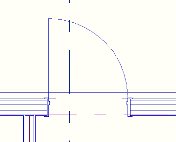

We have a complex wall profile that has a 4' wainscot and a ledge. When we place a door in the wall, it displays incorrectly in both the plan and 3D. In the plan view, the door frame is correct, but it doesn't cut the ledge. In 3D the door frame extends all the way to the end of the ledge. Any ideas?

Jay,
I just made a complex profile wall very similar to yours
and put a window and door into it and found that
they had all sorts of strange problems in 3D
including the ones you mentioned.
The door did not cut the brick wainscot, the exterior casing
separated from the jamb, and the jamb depth was some
arbitrary dimension that did not fit in the wall.
The window cut into the wainscot in 3D but not in 2D
but otherwise seemed ok.

There's so many things to consider (and then the complex profile system is full of bugs anyway IMHO).
To correct the 3D view, have you checked the following?:
Opening Reference is checked in the Profile Editor and the lines are positioned correctly;
Your door's 'Opening Plane' is 'Associated to Wall' (parameters panel);
For your 2D view:
I think this is just a bug mate. At least I haven't found a way to make it appear properly yet. Maybe someone else has?....

In section, I have finally gotten the door frame to align itself properly with the wall, however the casing on either side is misaligned.
In the following posts are images of the complex profile window, and the door selection settings.
I think I've adjusted every setting that's available - without success - and I don't see the option spoken of in the preceding posts.
Does anyone have any ideas?
