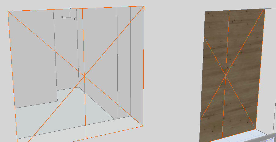

I was adding some downloaded objects, and then my windows and doors crashed. There's no details, shapes etc. Theres only one simple rectangle and it has one overlay texture.  I don't know exactly what kind of format cause this but probably obj.
I can close the program and reload it without saving, but i don't want to lose my progreress. Why it's like that and is there a way to fix it?

I don't think anything has crashed.
Check your Model View Option settings for the 3D detail of door and window objects.
They are probably set to simplified rather than full.
Or just change to a different MVO scheme.
