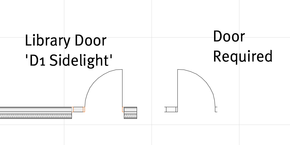

i am looking for a door which has a side light but has the hinges on the same side as the side light. I have tried the standard library doors but can not figure this out. Can anyone help?

I don't use the same library, but one would assume there's a toggle/parameter that changes the hinge side of the door. That's how the dutch library part works, at least.
Interestingly enough, I just put in that request via tech support, particularly where the sidelight is a full fixed panel, as it is a common patio door configuration here. Sounds like both the US and UK libraries have this issue if we're both seeing it.
(The current sidelight doors have another problem that the frame around the sidelight is all one size - but if you use a glass door panel, you can set different sizes for each edge. Typically, I find the bottom frame to be larger than the other sides - but cannot set the sidelight to do that with the current objects - at least the US versions.)
My workaround is to 'gang' (mull) two doors together, and to disable the opening lines for the door that is serving as the 'sidelight'. The physical representation works out fine - but door markers / schedules have to deal with the two objects, one of which isn't really a door...
If we have that in the US library, I can't find it... could you post a screenshot of where the parameter is?
