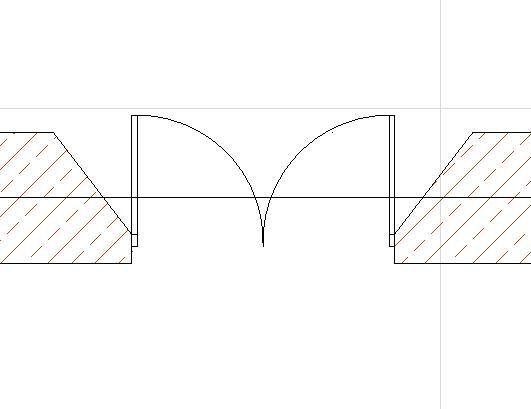

Can anyone help me to create a door like this in archicad . I tried with reveal options but couldn't find the right direction for opening the door.

1. Select the door.
2. Click the "Flip" button in the info box (yours might look different).
3. Done.
If you add a signature to your profile stating your OS and version of ARCHICAD, you're likely to get better answers for more complex questions than this one.
Cheers.

Hello,
Same as command+E (rotate)

Juha wrote:
Hello,
Juha, Ctrl+E / Cmd+E also rotates the entire door/window along with the reveal. I thought @jje92 wanted to do only one without the other... unless I am mistaken.
It is always nice when users who post questions acknowledge the responses and tell us whether the answers worked or not.
