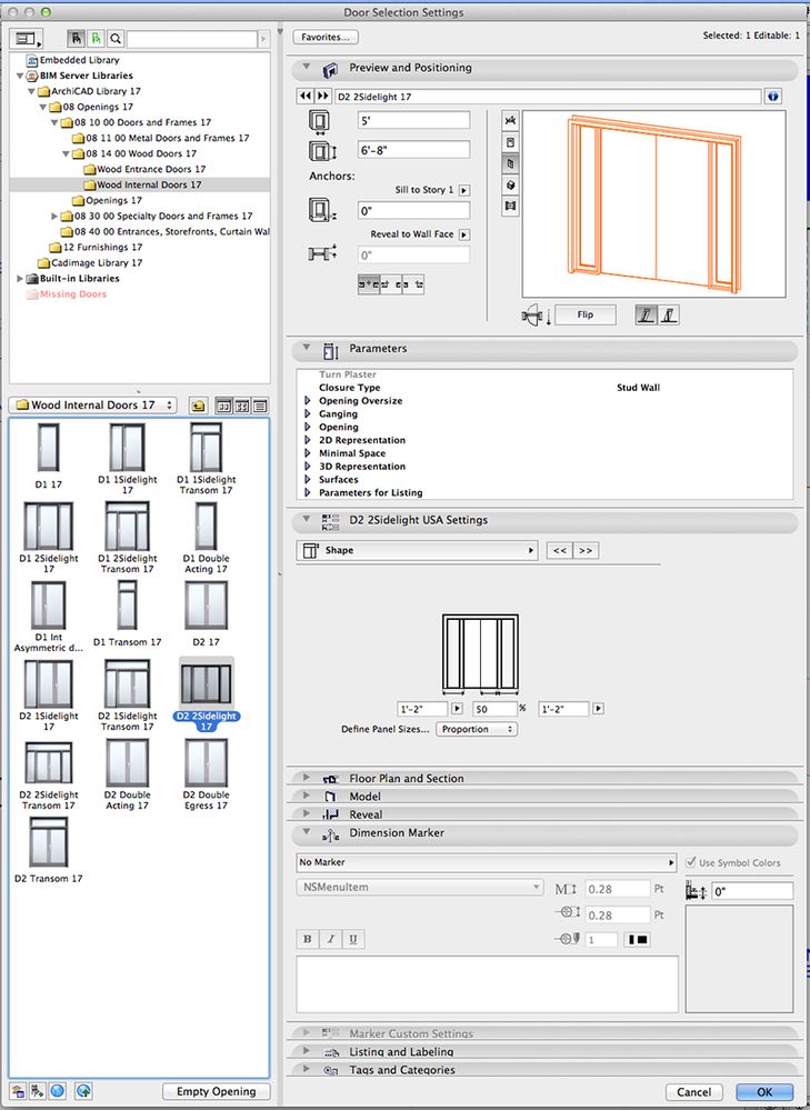

OK I think I spoke too soon....
remember I'm in the U.S....perhaps the International version has that option but the version I'm looking at didn't show me any place in the "shapes" area of the dialogue box where to raise only the sills for the sidelites....(see attached)

If I had to guess I'd say it will be in the entrance doors too!
Use the search function top left of the Door Settings dialog and try search for "sidelight" I have a feeling it will be in there!
That's interesting, also frustrating, in my AC the option shows up.
Try the D1 2Sidelight 17.

rob2218
that's because I see from your sig you are using AC18?
I'm using AC17. they didn't seem to have that option in AC17 to make the sidelites sill different than the door sill.
frustrating indeed.
