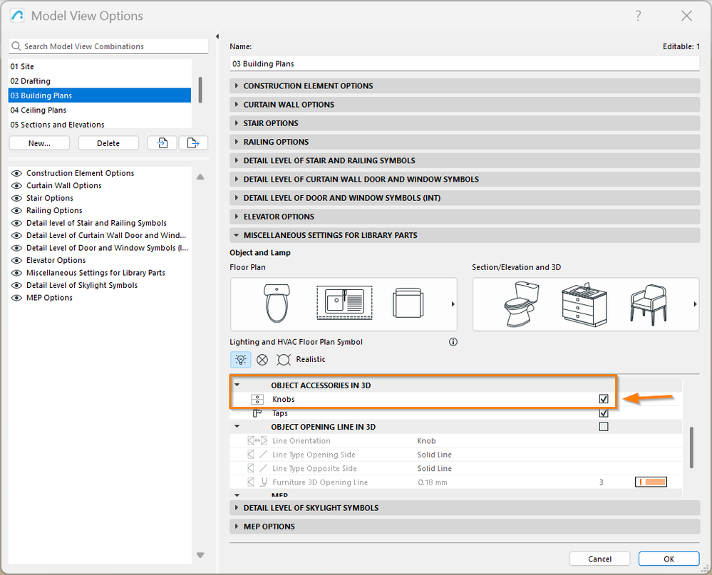

I put doorknobs on all the door, and they are not showing up. Shut the computer down and restarted it, no doorknobs. the menu shows doorknobs, but the 3D doesn't

Check if you have the correct Model View Options (MVO) combination applied to the view. In the MVO> Miscellaneous Settings for Library Parts> Object Accesories in 3D you can set if door/window Knobs are visible.
