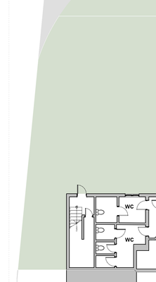

I have an issue where pens are showing different on the sheet than in the source view. On the sheet it looks like this (the red line I want to show is shown white):

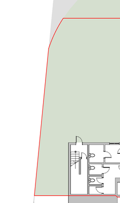

When I 'open source view', things are shown correctly:

It’s likely your Drawing settings are using a “layout” pen set. If you access the drawings settings, you can change the pen set to “by view” and it should match the source view.
