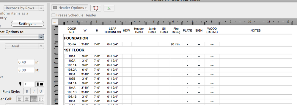

matjashka
Gentlemen, if I understand the 2-column problem correctly, it can be resolved with *ANY* AC door if you use a custom marker. Works for me and my "live" schedules. I did this to successfully eliminate having to put anything in Excel of PDF.
Let me know if you want me to elaborate... I don't remember exactly how I did this, but here's a quick-and-dirty result (see attachment). Is this what we're talking about...? This is all BIM-based, every single field is part of the door+marker parameter combination.
EDIT: oh, of course, the door ID here is actually a combination of zone number and door ID, not just manual door ID, just to be clear.
