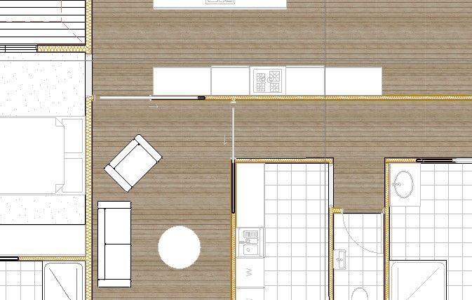

I've added cover fills to a floor slab and have noticed that some of the doors show on top of cover fills and some are obscured by the cover fills.
Any suggestions of how to fix?

It’s to do with the background fill to the symbol of the door. It’s witchcraft figuring out which part of the symbol fill you need to change but once you find it, it makes sense.

Thanks, its sure seems to be. Still to find it! the setting looks exactly the same of the doors showing and the ones not showing.

The different types of doors do seem to utilise fills differently. Try turning the toggle to use objects fills off and then try with it on and change the full type to background and transparent pen.
