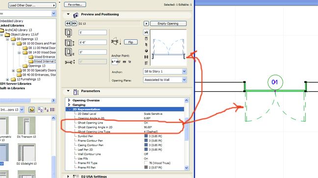

What about the following, showing the doors closed and then check the ghost opening option?
I don't really know what I want though... I was just checking to see if automatic door are shown the same in plan, in terms of opening as normal hinged manual doors are
I wasn't sure if you would show 2 lines perpendicular to the door because it doesn't open into the building but rather onto the perimeter. ( wall that the door is fixed to )
I will probably use the graphic you've illustrated and see what my tutor says.

To me the term 'automatic door' refers to its operation. As you near a door you step on an activation pad and the door opens without you, the person, having to manually open it. Automatic doors can open in any way including swing, sliding or overhead.
This 'automatic' designation is in the door schedule, embedded in the door specification data. There is typically no visual difference from any other door in the model.
