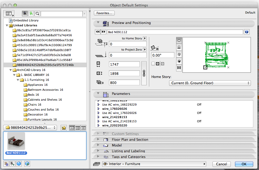

Do you mean in the objects selection settings? or in Options> Elemental Attributes> materials?
You have the element converted from 3DS. And there is material settings are specified in the script (DEFINE MATERIAL parameters) - a mirror. Turn on the checkbox Use AC Wire_ ... and assign a materials from requisites of of your project.
The 2nd one (Materials). In the Help files see:
User Interface Reference > Dialog Boxes > Material Settings Dialog Box > LightWorks Shader Settings
