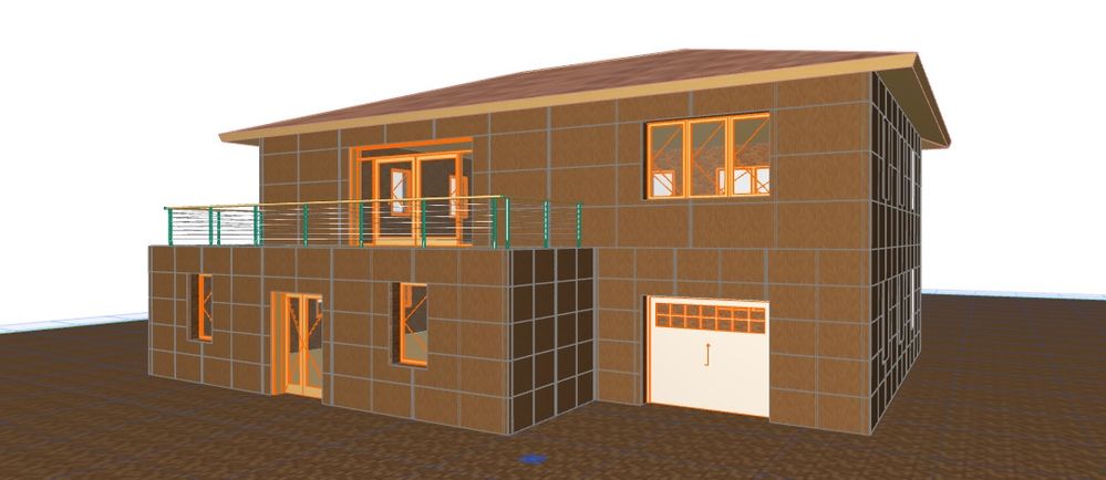

I finally managed to create the object you can see in the image. I mean the panels that cover the walls of the building.
This cladding is composed by panels and substructure. My question is: Is it possible to get a list or quantify how many elements of each type are there (panels/aluminium profiles...)? The goal is to make it easy to get a budget of the cladding system.
Thanks!!
