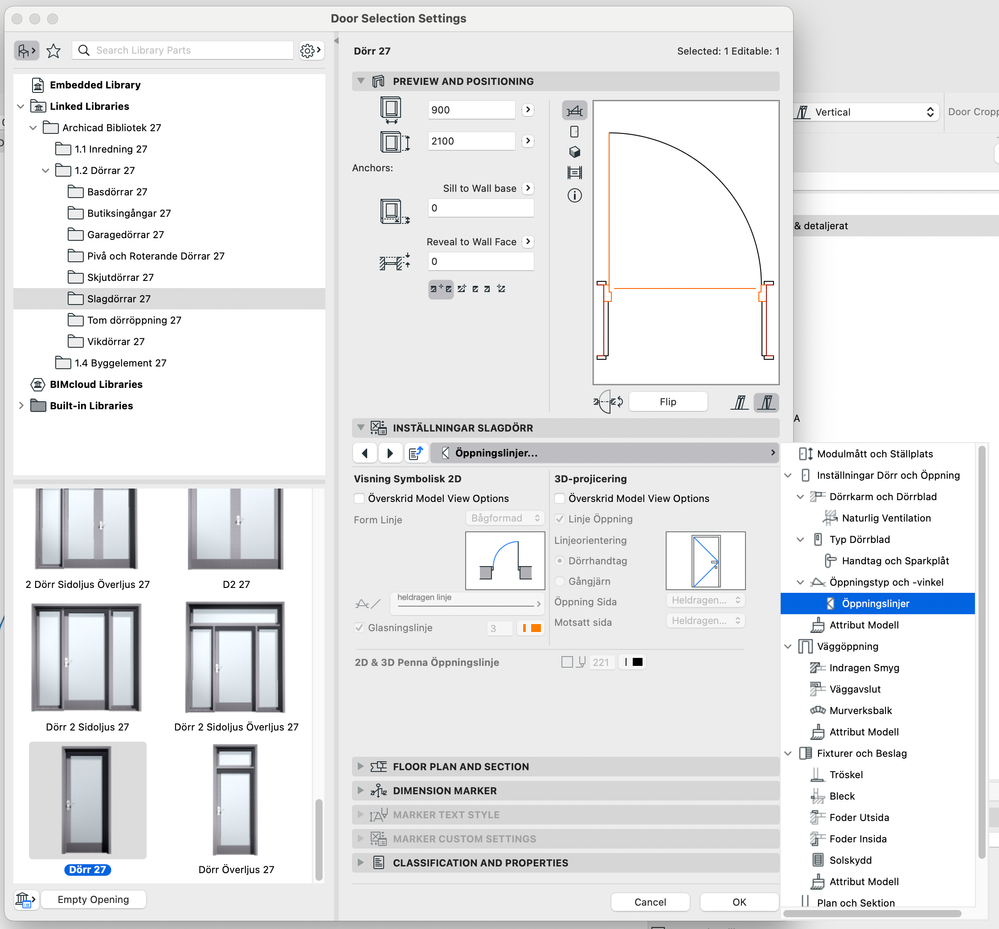

I noticed that one of the menus options for door is missing. When you have a door with glass panel you could turn of the glass line representation on the plan, but that menu is missing on Archicad 28.
I have the Library Update 2 installed.
Archicad 27
Archicad 28

Have a look in the Model View options.
I think this is what you are after.
Which unfortunately means these options are controlled globally and not for each individual door.
That can be good if you don't want individual control, but if you do, it is bad.

It helps thanks.
But it would be nice to do it door by door like before.
Yes, it has been discussed with Graphisoft.
Many times I have said that any object settings in the MVO, should also be able to be set individually in each object.
But they seem to not want to do that.
It is not hard to do, I do it for my objects quite often.
Maybe send an e-mail to your local support and ask them to forward it on to head office.
