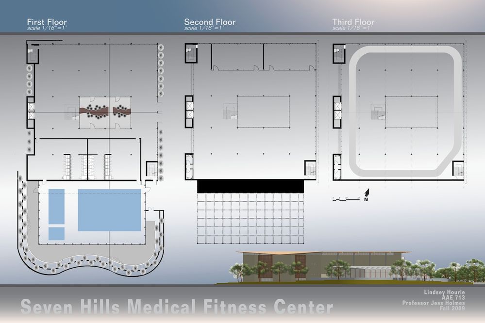

I've taught myself how to use ArchiCad over the past year but am still unfamiliar with some of the more advanced aspects of the program. I'm running the educational version and would like to set up a basic template or set of standards that I can use for all my school projects. For example, instead of manually changing all the wall settings when I do plan or section cuts from having no fill to having a solid black fill. I believe there is a way to automatically have all new walls look like this? I would also like to setup line colors and weights for the various objects, windows, doors, etc. I don't care for the odd colors and lineweights in the default template provided. I'm attaching some images of work I did this semester. This is what I'd like my template/standards to reflect. Any comments, suggestions, critiques, etc. would be of much appreciation.

Here's some elevation images
And sections and siteplan
If you want all the cut fills to be solid fill, black: check out the MVO (Model View Options). These can be used to globally affect the appearance of your views rather than adjusting each element or object type individually.
