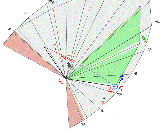

Hello!)
I place hotspot points in 3d to angle edition.
Base (4) and Moving (5) points has same coords.
Because on start editing, variable Delta1Angle3D must be changed from 0 to other value.
HOTSPOT 0, 0, 0, unID, Delta1Angle3D, 6 : unID = unID+1
HOTSPOT X, Y, Z, unID, Delta1Angle3D, 4+128 : unID = unID+1
HOTSPOT X, Y, Z, unID, Delta1Angle3D, 5 : unID = unID+1
HOTSPOT X1X, Y1Y, Z1Z, unID, Delta1Angle3D, 7 : unID = unID+1
I specify reference point (7) on right plane. But anyway editing going in wrong plane (red arrow on picture).
But I need to editing on plane with blue arrow (by points 6,4,7)
Help me please ((.
7 Replies 7

No, not X-Y plane.
This is plane in 3d window by 3 points (in the picture) - (№6,№4,№7)
If you are trying to move X, Y and Z all at the same time I am pretty sure that is not possible.
3D hotspots can only move in one plane at a time as far as I know.
On picture showed - moving goes, but on wrong plane (red arrow).
Usually plane specified by 3 points -
- base (type4)
- center (type 6)
- moving (type 5)
But if on start moment, base = moving (need change angle from 0 to ...)
And in this case plane positon on interactive moving is bad.
Because for specify plane - two points is too few.

Point 6 is the centre.
Point 4 is the starting point (base).
Point 5 is the point you are trying to move.
These 3 points should all be in the same plane.
Point 7 should be a point that is perpendicular to that plane.
(or maybe it defines the angle of the plane - I usually just do it flat in the X-Y plan and ROT the whole routine if need be).
At least this is the way I have always understood it to be.
From the GDL manual...
The plane of the angle is perpendicular to the
vector that goes from the center hotspot to the reference hotspot.
Thank you so much!))).
I do not properly set the reference point.
In 3d it's on the perpendicular plane should be.
Now it worked!)))
What a joy.
Thanks again!
