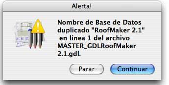

The next time I opened the file, I found a problem, an error report: name of data base duplicate (RoofMaker 2.1) in line 1 of file Master_GDLRoofMaker 2.1gdl.
I click continue, and need to click 3 more times with the same Alert as you can see on the attached image.

I think that You have the mentioned "Master_GDLRoofMaker 2.1gdl" in the PLA-archive AND in Your built-in ArchiCAD-library. Both of them is trying to configure the same calculation database and thus generating the error.
Just expand the PLA and delete the file "Master_GDLRoofMaker 2.1gdl" and the errors should be gone.
