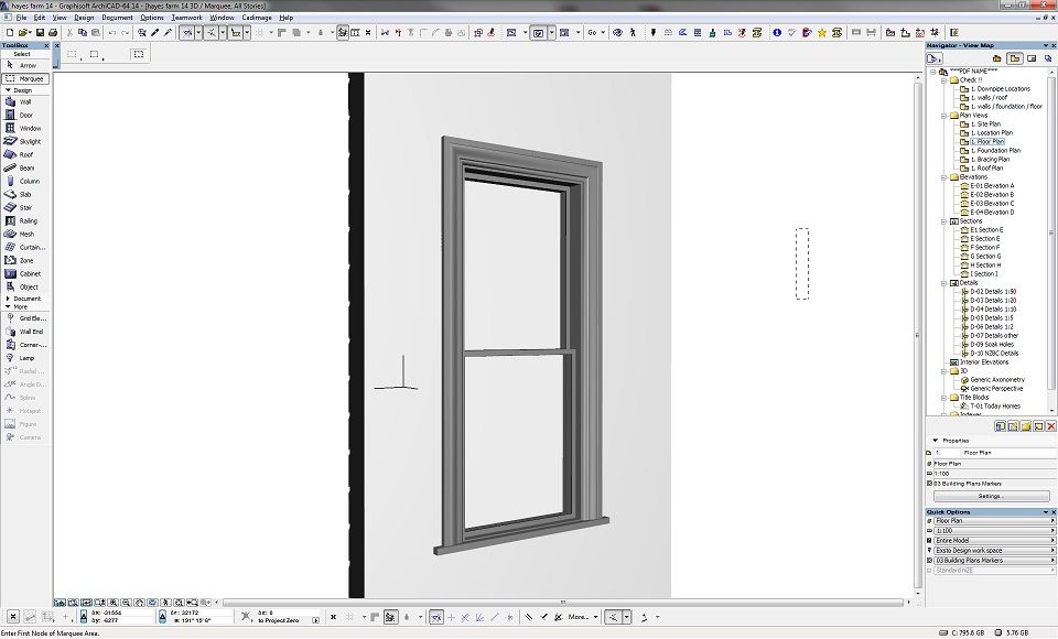

Here is a screenshot of a job I am currently working on.
Danj wrote:
Cadimage Door+Windows addon can achieve this.
I'm not saying it can't be done. I've made many such libraries myself. It's just not as simple as you might imagine.
