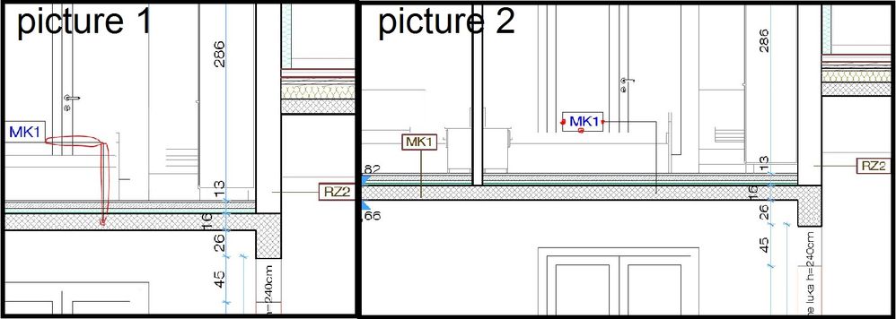

I need custom LABEL i used one that is alredy in ArchiCAD (Generic label 20)
and all I need is ''Show composite/profile/material name''
butt i hate the two lines in pointer so can anybody make just one, pls? (picture 1.)
And also connection point I need just two (tree) (picture 2.)
in drawings are other ''labels'' it's just text and line so if anybody can hepl me or create label that i need i will appreciate so much Very Happy

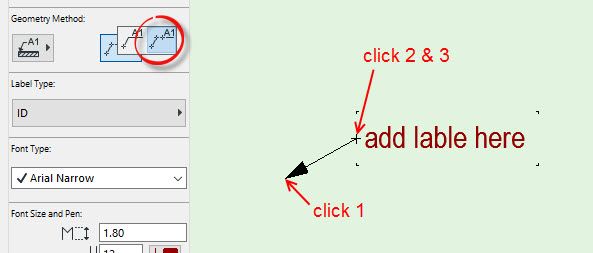

Now in answer to your question.
You don't need the two lines.
You can place with one now.
Just use the "Detailed" geometry method and double click for points 2 & 3 (the second line).
See attached image.
undefined
As for the anchor point location of the line to the text the label only allows for the side - top, middle or bottom - left or right side depending on how you place the label.
It can't come from the bottom middle of the text.
I don't think this can even be solved with GDL scripting - which is why I moved this post here.
Someone that has tried might be able to answer.
