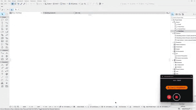

Both NCS and standard labels are behaving similarly. When I place a single label, the ID is unrecognized. If I select Document->Annotation->Label Selected Elements the label behaves inserts correctly.

Your label tool is not set to 'Associated' geometry method.
When you use the menu command you select the element and it is automatically associated when you do that.

I see. Interesting that setting is only available in the info box and not in the label settings. Thx
